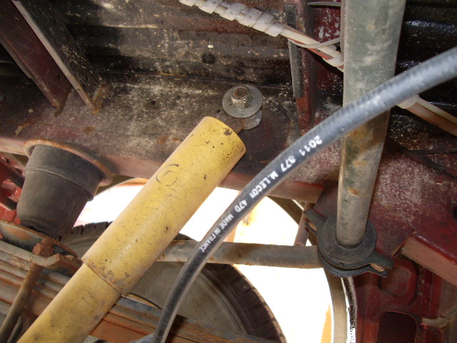

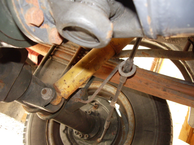

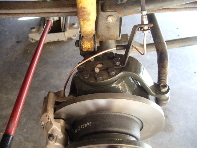

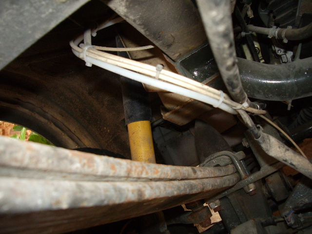

Beitragvon deepurple » Freitag 6. September 2019, 12:32
Max 30mm but more 20mm.
Pictures with shocks .
Bruno.
