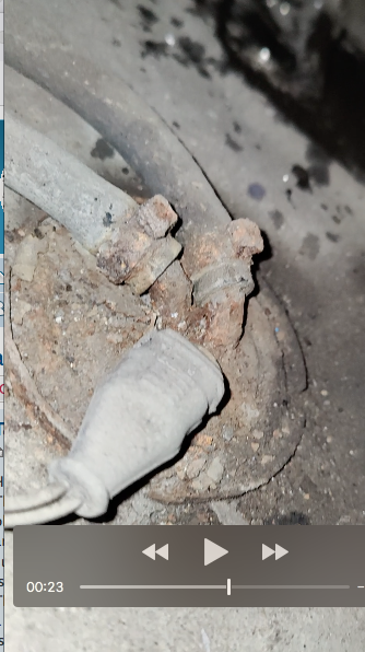

The fuel gauge on my 1993 LT 45 chassis cab with ACL engine is not working. I tried to disconnect the 2 pin plug to the fuel sender but the plug broke off where it attaches. It may still be in contact. It's difficult to check as I'll need to remove the tank for access. I took some photos and the pipes look very corroded. So far no problem with fuel flow but it needs replacing. Problem is there are none I can find available. I'm not sure what part I need but it seems the part is 281919051 BH. Is that correct? I cannot see any part numbers through all the rust.
Is it correct that I cannot use the 'B' version for older diesel LT's because of the different resistance values or could one of these B's be used? The parts list has an 'L' version that says 6mm and the BH is 8mm. I'm assuming that is the ID of the hose it takes. Would it be wrong to use an L instead of the BH if indeed it is a BH I require? I assume it would feed a lower volume of fuel due to the smaller diameter.
Is there a way of repairing these things or a generic part that can be used instead?
Any help would be appreciated.

Ich kann jetzt einige meiner eigenen Fragen beantworten. Der ältere Geber 281919051B passt nicht. Er hat ein einzelnes langes abgewinkeltes Rohr und einen Stutzen zum Anschließen eines Schlauchs. 281919051L passt, hat aber ein 6-mm- und ein 8-mm-Rohr. Bei mir sind beide Rohre gleich groß, also ist es höchstwahrscheinlich 8 mm, 281919051BH oder BG.
Wenn ich L verwende, wird der Kraftstofffluss behindert, wenn eines der Rohre 6 mm statt 8 mm hat?
Gibt es andere Lösungen? Vielleicht rostige Rohre abschneiden und neue Rohre einbauen? An Ort und Stelle schweißen, löten oder verlöten?
